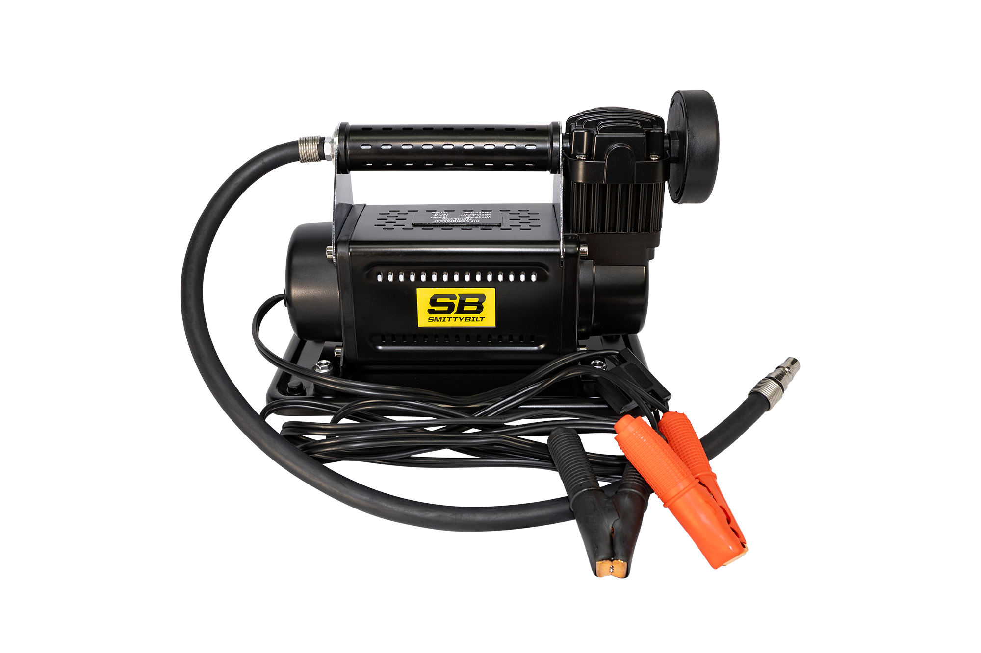

Based on the price of those alone they are going to be slooooooowwwww to air up tires. Read the reviews...
If you could step up to one of these, you'd be much, much happier.
Also, know that for most of us, not towing with normal loads, we can get away with 45psi all around on the stock tire size. That might be enough for you. Airing down to 25-30 will help dirt road ride a ton though.

thanks. I’ve looked at things like this or even the ford performance one that comes in plastic box. Not opposed to these as still much more affordable and multi use.
Do you have experience with either of the SB or HF you posted?
