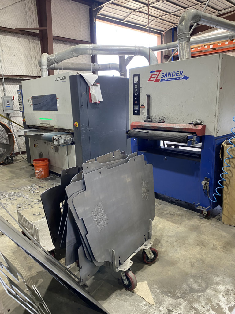

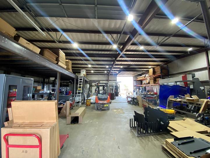

Figured I’d give a quick look at how the shop is laid out since I’ll be posting updates from here.
It’s a mix of organized and mid-project most days. When we’re running parts it doesn’t stay clean for long, especially once material starts moving through.
We try to keep the workflow pretty simple and linear so parts don’t bounce all over the place.
Raw sheet comes in and goes straight to the CNC laser.
From there parts move over to deburring and edge finishing on the Loewer 4TD and Apex EZ, then over to the Mitsubishi press brake for forming. After that everything goes to welding, and finally into the powder coating booth and oven.
Most of the efficiency really comes from that flow — once parts start moving, each step feeds the next one.
We’re running Miller welders for assembly, and having powder coating in-house helps keep everything moving without waiting on outside vendors.
Still making small changes here and there, but the overall flow is working pretty well right now.

Every skid plate we ship starts as a flat sheet of metal. Getting from that to finished armor takes a handful of machines, and each one does something the others can’t.
Most of the process starts on the CNC laser. We're running an Oree 6KW fiber laser with an exchange table. That's where everything gets cut out — holes, slots, and overall shape. It's probably the most important machine in the shop.
If the laser goes down, everything else basically stops, and it's also the hardest machine we have to keep running consistently.
From there parts go through edge finishing. We're running a Loewer 4TD Disk Master and an Apex EZ sander. The finish the Loewer puts out is what sold me on it — it was a big step up from the Apex, which we still use more for steel parts.

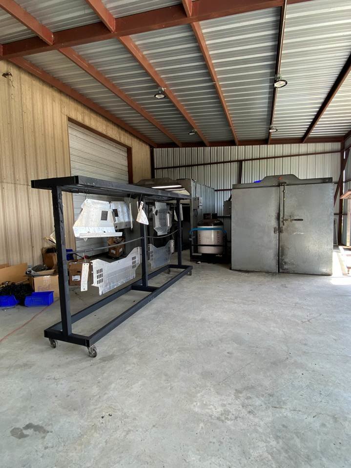

Last step is powder coating. Having that in-house keeps things moving and avoids sending parts out.
Each machine handles one part of the job, but the real efficiency comes from how everything flows together.

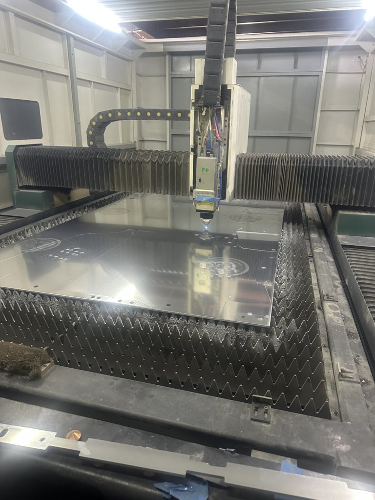

Ran a full sheet of skid plates on the laser today. Every part we make starts here — if something is off at this stage, it carries through every step after.
Most of our parts start here. Everything from the overall shape to bolt holes and slots gets cut at this stage, so if something is off here it carries through the rest of the process.
We didn't always have the laser. Originally I was cutting everything on a plasma table, which worked, but the edge quality and hole accuracy just weren't where I wanted them. There was a lot more cleanup before parts could move on to bending.
Switching to a laser made a big difference. Cuts are cleaner, holes come out right, and it saves a lot of time downstream.
We're cutting both steel and aluminum — mostly 1/4" aluminum and 3/16" or 10ga steel — and they behave pretty differently. Aluminum can be a little more finicky, especially on thicker sheets, while steel is a bit more forgiving.
One thing I learned the hard way is how important it is to keep parts from tipping up during cutting. If a part lifts, the laser head can catch it, and that gets expensive fast. I've destroyed a cutting head before because of that.
Now we use tabs to keep parts stable in the sheet while cutting, which has made a big difference.
Running the laser also takes more air than I expected. We ended up running a high pressure setup around 300 PSI to keep things consistent.

Always a good feeling when a full sheet finishes clean and everything stays where it's supposed to.
Ever had a cut go sideways on you? I’ve killed a cutting head before — curious if anyone else has had an expensive “oh no” moment at a machine.

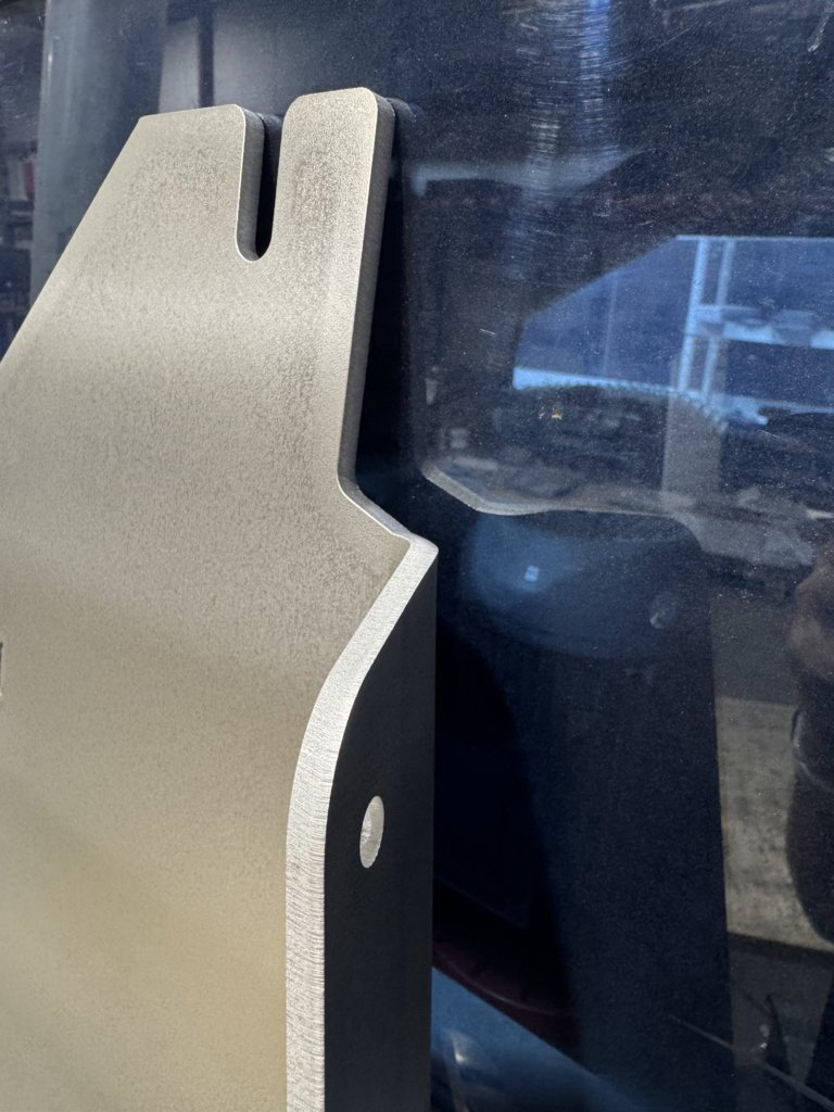

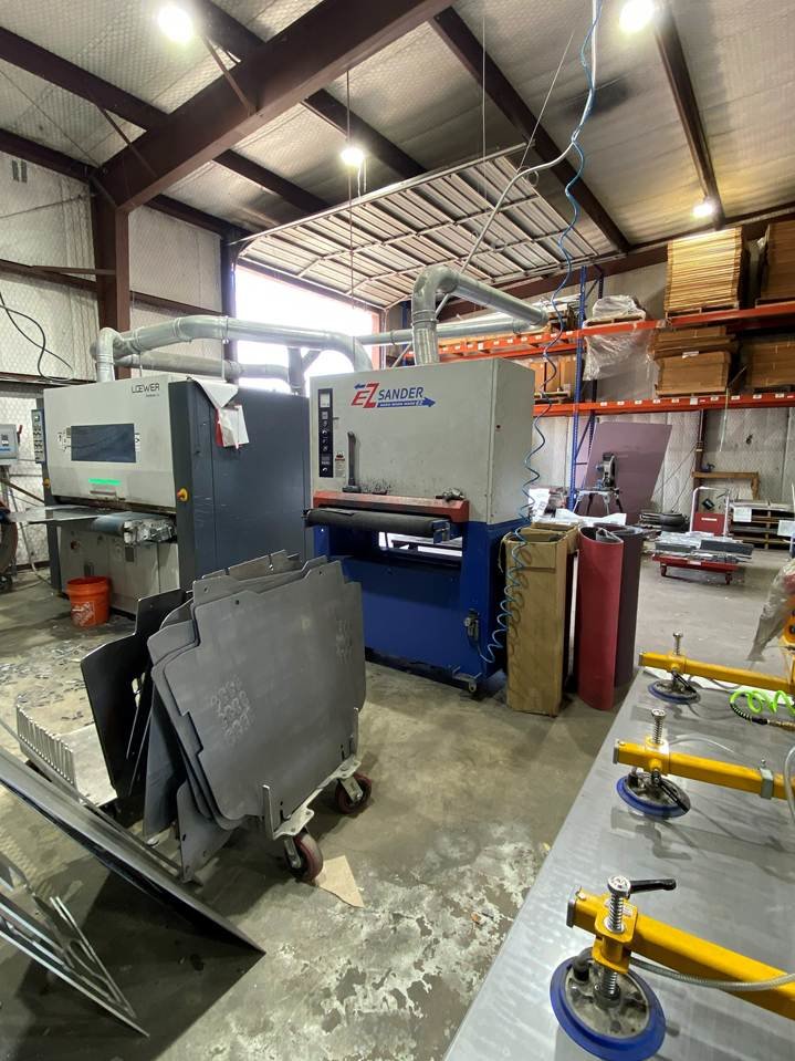

Edge finishing is the step most people never think about, but absolutely notice when it’s skipped. It’s also one of the most overlooked parts of building good armor.
Fresh off the laser, parts look good but they're still razor sharp. Especially on thicker material, edges can be rough enough that you don't want to handle them without gloves.
Before anything goes to the press brake, we run everything through edge finishing. It cleans up the edges, knocks down any burrs, and makes the parts a lot easier (and safer) to work with.
We're running both a Loewer 4TD Disk Master and an Apex EZ sander. The Apex still has its place for flat sanding, but for rounded edges we needed the Loewer.
The Loewer is what we use for most aluminum parts now. I was honestly surprised how big of a difference it made —the edges were way sharper than I realized.
Gears and Gadgets actually got a set of plates from us before we had the Loewer and then after, and even he noticed how much cleaner the edges were.
One thing that did surprise me though... the Loewer is slower than I expected, even after seeing it in person. Still worth it, just something I didn't fully appreciate until we were running production through it.
Despite how sharp the edges used to be, my wife somehow managed to keep her soft hands intact helping in the shop.

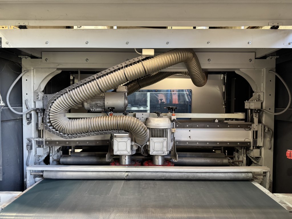

A sneak peek inside our 4TD. Each brush has its own electric motor.
You can see the frosted edge on the skid plate after running through the machine.
The brushes have 100's of individual fingers that allow them to fall into small holes. These brushes are over 500 dollars each, and we need two to run.
