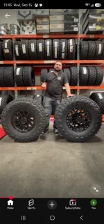

Apex Prolock Dom steering kit, Dynatrac HD ball joints, PPE rear diff cover (I have an M300 11.8 rear), the tire on the right with Chas is my actual wheel setup. Hostile 601 Rapture Asphalt 18x9 +12 with 38x13.50 Toyo RT Pros. Maxx Sensor tpms and Apex RPV's.
