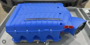

Upgrades Round 2 - Install Est October 2026 (everything is paid and ordered)
  • Whipple Gen 6 3.0 Supercharget Kit - in Ford Texture Blue

  • Lethal Performance Whipple Supercharger Reservoir - hoping to powder coat ford texture blue

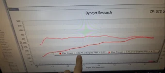

Truck is Supercharged now. I haven’t seen anyone give a real breakdown like this before on the websites I viewed while researching this.
I went to National Speed Inc. in Wilmington NC. This is my third time there. I went for stage 1 and stage 3+ on my 2016 tundra - that got to 499-wheel horsepower on 37’s. It was awesome.
I am currently on the full catalog of PMF 2-inch suspension lift and 37s on 18s with fox 2.5 performance shocks all 4 corners and new leaf spring pack. It’s a 2022 F-250 4x4 with the 7.3 non-tremor 3.55 gears that was custom order from factory. I am 2nd owner since 91,000-ish miles. Previous vehicle was a 2021 Ram TRX – so a supercharged truck is a must for me.
Anyways here are the items that went on during this build, some items I bought myself and some the shop bought (they had to buy the supercharger to warranty it).
$9,749.99 - Whipple Gen 6 3.0 Supercharger

Baseline Engine Rating – 430 hp and 475 tq
Baseline Dyno – 341 whp and 370 tq
Roughly 20% and 22% driveline loss
After Install Dyno – 612 whp and 598 tq
If we consider 20%/22% from baseline – 765 hp and 766 tq estimated at Engine
It is very noticeably faster than my Supercharged Tundra and it’s 90% of what my TRX was (at least passing power wise). I do miss the awd from the TRX but I love everything else about this Ford. Next round of upgrades will be traction bars – I do not have any wheel hop as of now, 58-gallon fuel tank, and a big break kit – I currently do not have a front sway bar but I might add now. Extremely happy with how it turned out.
