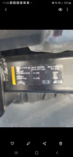

I just picked up my truck yesterday and noticed the same thing last night. Here is a picture of my receiver. I have a 7.3 F350 XLT...
Yea, My 2020 XLT F350 Tremor has the 15K rating. Which Sucks a little because it can use the 18K 3โ€. But I will live with it, not a deal breaker.

Well, after a long three and a half month wait I finally took possession of my 7.3 F-350 Tremor tonight. Once I got home I noticed that the receiver hitch says class V with a rating of 18,200. If you read the Ford towing guide it says that a 7.3 F-350 Tremor is only rated to pull 15K off the bumper. What gives? Anybody have an answer? Did I get an incorrect receiver?
do you have a 3in receiver or 2.5 in
