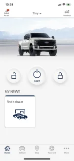

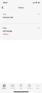

There might be a bug in the application. I also have my wife's Edge on FordPass and because there is a recall on brakes I have a red exclamation mark on the Recall icon in the upper left corner of the application. When clicking into that, I see my trucks nickname and the windshield recall displayed in there. At the bottom of the recall notice it will also allow you to schedule service (which I haven't used yet).

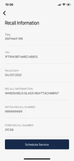

Mine didn't as well until I clicked into the recall screen. The recall date was 4/7 and the recall number is 21C06. I'm not sure why it doesn't show the red exclamation mark or show the recall on the second screen.

When you are on the home page for your vehicle, if you have a recall, it will have a red notification symbol in one of the upper corners of the screen you can click on and the notification page will open.
