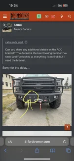

This is the Warn Ascent HD with full grill guard option. I’m a HUGE fan, this is my second one I’ve owned. Ranch hand protection with a pre-runner look. Powdercoat quality and ease of install is nice as well. Also added a picture of my Onx6 30 arc mock up for a mounting system im fabricating for mounting without drilling into the bumper.What front bumper is that? Any more photos of it?

Can you confirm if you're Warn bumper works with ACC? It doesn't appear that it does, even based on the instructions and the last time I called Warn, they couldn't confirm and never got back to me.This is the Warn Ascent HD with full grill guard option. I’m a HUGE fan, this is my second one I’ve owned. Ranch hand protection with a pre-runner look. Powdercoat quality and ease of install is nice as well. Also added a picture of my Onx6 30 arc mock up for a mounting system im fabricating for mounting without drilling into the bumper.

I don’t have ACC and it does not come with a bracket; but this gentleman had a few small holes drilled and made his factory sensor work!No sir. The only option in that case would be a hitch receiver mounted winch.
Can you confirm if your Warn bumper works with ACC? It doesn't appear that it does, even based on the instructions and the last time I called Warn, they couldn't confirm and never got back to me.

Great info, thank you.I don’t have ACC and it does not come with a bracket; but this gentleman had a few small holes drilled and made his factory sensor work!

She is coming together nicely! Hit a snag with the Warn bumper as it doesn’t have an adaptive cruise bracket. THOR Off-road in Dripping Springs, TX (very happy with their service btw) is going to fabricate an integrated cutout bracket to make it work. I have the e-venture, but decided to hold...www.fordtremor.com
