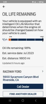

I just changed my oil last Saturday. Drove about 220 miles since then.
@Mattlikesbikes is this the first oil change for you? How much time did it take to acquire the 1000 miles??
Give it a chance to run its course, I am confident the rate will slow down. Also FYI just because it says your due it dosent mean you have to stop and change the oil. All that is, is a recommendation, it can wait.
I personally use Motorcraft 10-30 as recommended my Ford, and change every 5k. If I were to use full synthetic I would change every 8k. I do little towing, so don't see the need for synthetic.
FWIW I've been changing my 7.3l at 5k since I got it and has been around 50% oil life at every change with ford synthetic blend. I just recently swapped to mobil 1 full syn will compare oil life when I hit 5k. Not sure like some said how accurate the minder is. Also this might just be a 6.7 glitch.
3K first service for me, and then 5K after. Sometimes I am just under 5K, but I never will go over. I have been bringing it to the dealer each time to work with the warranty (if needed). I typically do the "works" from ford which includes fluids and a tire rotation. Last time they forgot to adjust my pressures.
