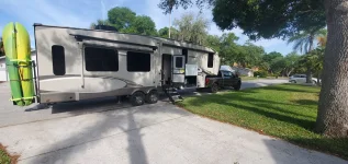

Just towed our 12k lb 5th wheel with my f250 Tremor. Came from a Duramax so I had to lift the trailer 4" for 6" of bed rail clearance and perfectly level. I tow using the Anderson Ultimate Hitch that installs over the gooseneck ball. I've tried everything over the years and I like the Anderson hitch the most.
2nd day owning the truck I installed the b&w turnover ball and spray lined the bed and fender wells. View attachment 1463
Did you have to flip the axles on your 5th wheel to achieve the extra height? Or did they leave the axles where they were with a "spacer"? Wondering as I am picking up a new 5th wheel next week with my Tremor that looks exactly like yours. The dealer seemed to think they could make the adjustments at the pin box. I would be "OK" with a slight angle to the 5th wheel stance if possible. I have the BW turnover with the Andersen Ultimate as well towing my current old HR Presidential (11K) and works great. Let me know. Thanks. Tim
Forgot to get a picture hooked up lol. Didn't pay attention to drop or spacing, but towed great. I'll get a pic on level ground when I pull this boy out of here.
Did you have to add an extra step to the entryway with the extra height on the 5th wheel?

I did a short tow with the Tremor a couple days ago and it works fine. I had MORryde add their IS suspension and disc brakes to my new 5th wheel before it was shipped to me. I had them raise the 5th wheel 2" because of the extra height of the Tremor. I dropped my hitch height 1". After those changes, I measured the height of the 5th wheel at 13' 5.5". Sits pretty level. The truck dropped 2" when I attached the 5th wheel.

5 th wheel is all set up. Long story short my 3500HD Chevy was lower to the ground by a lot. It was 4x4.
I raised the RV up as far as it could go and was 2" short for the Tremor. I let the air out of the rear tires. My apple watch immediately told me my tires were low. Backed under it . hooked up, re-inflated the tires. Got it all set. I was able to drop the pins in the legs so its very easy to move again. All good
