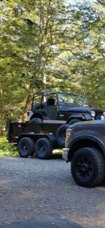

I have a Big Tex 14LP, payload is only 9750 pounds due to all the thick frame rails I'm guessing.
Hate the D-rings in the bottom of the bed, debris gets caught in them constantly. Rear drop legs are critical when loading heavier equipment.
It's amazing how heavy Big Tex's trailers are. But they can take a beating.
The Southland I got has the D-Rings on the bottom too. Very unfortunate. Part of what makes loading larger equipment on it a bit of a puzzle.
