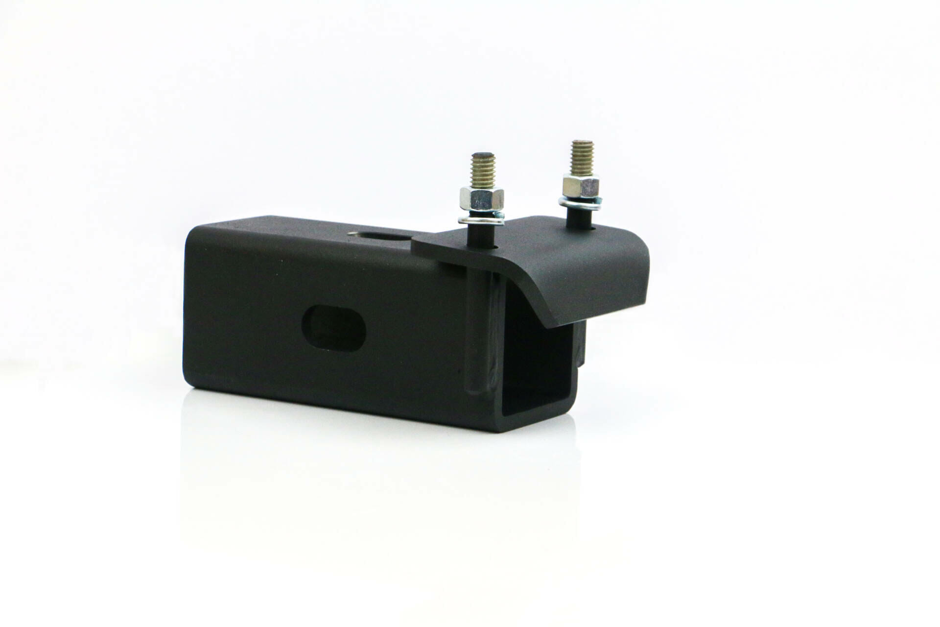

So from what I have read here (and other places) it seems that using a sleeve is ok. I'm coming from an F150 with a WDH to the Tremor. Is that the experience here? Thanks
An anti-rattle hitch clamp can make all the difference in the world. By nature a WD hitch will set up tension between the insert and the receiver and make them rattle free when towing, but when detached the play in the sleeve and other components can be quite sloppy and noisy when driving. An anti-rattle clamp makes the connections between the receiver and the insert rock solid. Keep in mind that your capacity will be limited by the smaller insert shank.
I tried them with my WDH and didn’t like them. I think the play in the sleeve caused extra tension on my pin, and it bent. Perhaps the pin was weak, but I feel better using a shank that matches the size of my receiver hitch.
