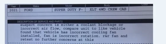

MY Brand new 2021 F250 SRW 4x4 Crew cab with 7.3L DEVCT NA PFI V8 engine broke down after 305.7 Miles.
"Engine Coolant Over Temperature" light came on.
Purchase date 7/9/2021
Break down date 7/11/2021
Ford wanted to charge me almost $200.00 to tow my brand new ford into the shop. I was 350 miles away from home.
Ford told me that they would not give me a loaner vehicle, any compensation for a room, or transportation to where ever I had to stay for the night.
Newberg OR Ford dealership found that they had the "incorrect cooling fan installed, fan is incorrect rotation. r&r fan and retest no further concerns at this" 7-14-2021
Waiting to see is Ford will give me anything now?????

Note to self: adding checking the fan orientation to my receiving checklist.
Anyone know which way the fan turns (clockwise or counter-clockwise)? Without knowing that obviously can't tell if the blades are pitched incorrectly.
Just checked mine. Hadn't experienced any issues but you never know. Mine is right. ?
How did you know it was right? Is the direction of rotation marked under the hood somewhere?
(Don't have my truck yet, but planning to check this when I receive it.)
The quickest is to start it and hold your hand over the intake manifold. You should feel air blowing strong toward the windshield. Also once you see the direction it's turning, the blades should slope in the direction to move air toward the engine.
The quickest is to start it and hold your hand over the intake manifold. You should feel air blowing strong toward the windshield. Also once you see the direction it's turning, the veins should slope in the direction to move air toward the engine.

it's easy to check the fan just open the hood with the engine running you'll feel the air blowing over the engine if you don't feel the air then it's the wrong fan. i just did it with my 7.3 & you can feel the air it's like a little hurricane under your hood. ? ??(y)?
