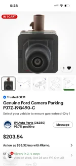

yep, PJ7Z-19G490-C is the newer, superseding part number for the Ford Camera Parking, replacing the PJ7Z-19G490-B and PJ7Z-19G490-A. If you want to see some pics, I have some in the is post earlier in the thread where I had ordered the correct part number from ebay and it didn't work (presumed fake), so I pulled the camera out of my tailgate and used it. Later, I ordered the same camera directly from ford and it worked and so I put that one back in my tailgate (which now I just have in storage because the camper is on full time).

Here is the link to the previous post where I mention places to get camera housing and cables, or entire kit. Pick and choose options with and without camera, cables, etc.
https://www.fordtremor.com/threads/24-owners-who-removed-tailgate.18096/page-14#post-464583
