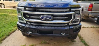

Will this work with the winch? Your need is the reason I put in 2 of them. Just never got around to the battery tender.
That was what I was originally thinking but the adaptive cruise module, I believe, blocks the drivers side location. I’m assuming you don’t have it?
I don't. I just have a peasants version of the Lariat with the value package!
