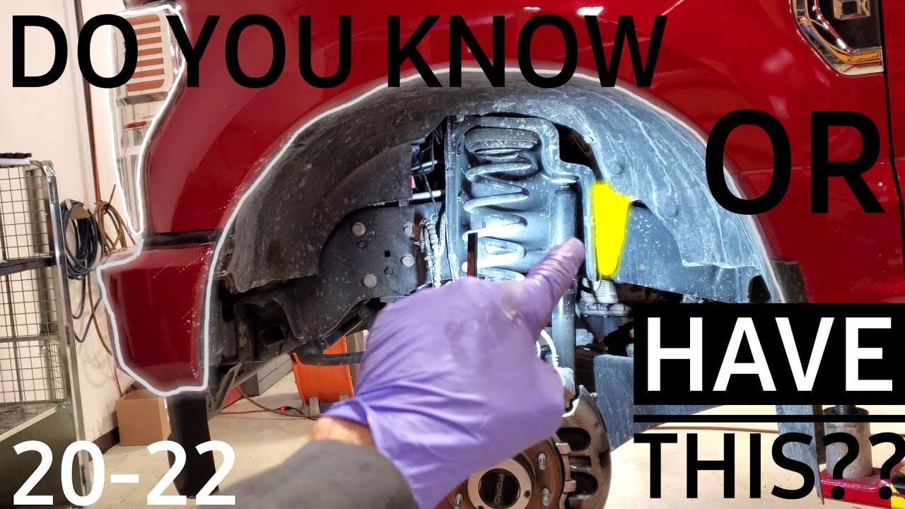

Check out this video that shows the part that does it. It’s an electric motor on the steering shaft in the engine bay.

Thanks! Looks like a motor actuator on the steering shaft... It looks like is is primarily part of the "AdvanceTrac® with Roll Stability Control® (RSC)." and then on top of that you can add the UTT Pro with BackupAssist and/or A.S.

Yep! Pretty slick that they were able to use the same part for both purposes.
