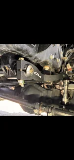

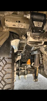

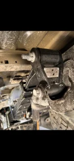

UPDATE:
So the above upgrades were done. And got some miles under it. Honestly very noticeable difference and much improved ride. For my application and what I wanted I think this is the best value with high end parts. Might add shocks later but doesn’t feel like the factory shocks are struggling. Also it looks a little more level altho it wasn’t one of the objectives. Here are some of the pics of parts installed.

you did leafs, shackle, sway bar and links...
you said it looks a little more level, do the leafs make the rear sit lower?
thanks
thanks
It seems.. maybe 1inch or so. Didn’t measure the before. But to the eye it looks more level. And yes it would be the softer leafs that caused that.
