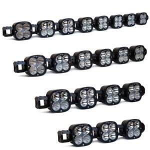

That same thin XL housing also gave us something we weren’t planning on. We took the moto-specific Sport and Pro, built links for them, and ended up with the XL Linkable that allowed us to connect multiple lights into a single light bar and build exactly as much light as the application calls for, with complete adjustability and modularity to create a 3XL to 9XL linkable light bar.

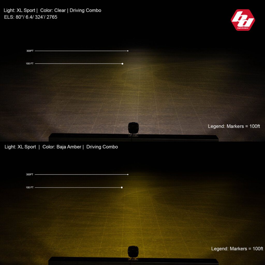

XL SPORT​

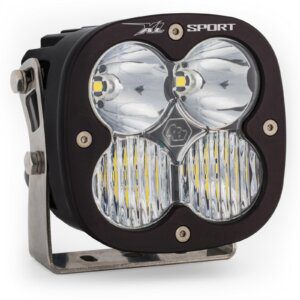

The Baja Designs XL Sport is where most people start. Putting out 3,150 lumens on 26 watts and 2.2 amps. It’s the entry price into the XL family, but that doesn’t mean the light is compromised or bad at all. You still get 5000K, ClearView optics, and serious off-road performance.

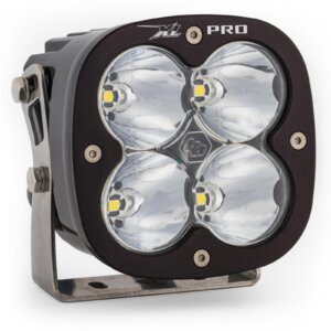

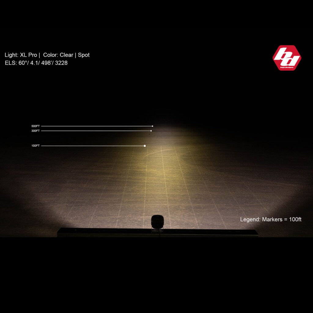

XL PRO​
The Baja Designs XL Pro is the original XL of the series and the workhorse that mostly gets overshadowed by the XL80 constantly. At 4,900 lumens and 40 watts, it’s the middle of the range on paper, but the XL Pro will be perfect with any of Baja Designs ClearView lens patterns, which means the same light can be a cornering light on an A-pillar, a driving light in a grille, or a high-speed spot, depending on what you put in front of it. If you’re only buying one XL and you want it to do it all, this is it.

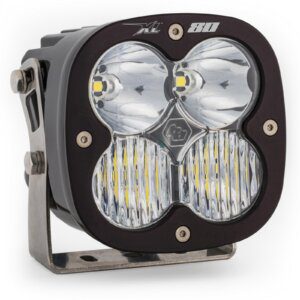

The Baja Designs XL 80® is the powerhouse, and it is exactly what it says it is: 80 watts, 9,022 lumens, about 5.9 amps. It is the most powerful light in the lineup, and the beam pattern wasn’t designed to throw the light the furthest. The light was engineered to be intense in the near-to-midfield, and we only sell it with a combo lens on purpose. In fact, the XL Pro throws light further than the XL 80 despite being less power, and that is because of the combination of different LEDS are used on the corcuit board.

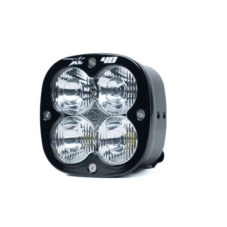

The XL 40 is our first light designed exclusively for moto use. Born from the powerhouse of the XL 80, the XL 40 was engineered to bring that same trail-proven performance to a wider range of motos. The design ethos was simple: build a light that’s still bright enough for the trail, but compatible with the majority of motorcycles running lower-output OEM stators. At 43.5W, the XL 40 draws significantly less power than the XL 80’s 75.9W platform making it the right light for riders who’ve been left without a high output lighting option for their motorcycle until now

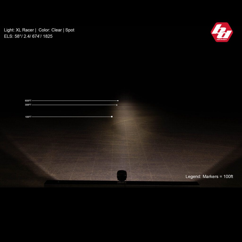

The Baja Designs XL Racer Edition is the light built for anyone running north of 100 mph. You’d expect the light made for the fastest drivers to be the brightest of the bunch, but it isn’t; however, it does throw light the furthest. It makes fewer lumens than both the XL80 and the XL Pro, and it throws light roughly 45% farther than the XL Pro, because every watt in it goes toward distance instead of intensity due to the size of the LED die. It makes 2800 lumens at 45.5 watts, and the beam pattern is thin and narrow. We only sell it with a spot lens, and it shouldn’t be run by itself because it is a piece of a package to compliment a lighting package for racing.

The Baja Designs XL Linkable LED light bar kit is available in Sport or Pro, was engineered utilizing our moto housing. The XL Linkable can be built with 3 up to 9 XL Sport or XL Pro forward projecting lights that provide a smooth blend due to the use of multiple lenses illuminating various lighting zones. The system provides 45 degrees of vertical pitch adjustment within each light or the entire unit. Completely independent horizontal adjustment per light allows for straight or arc configurations to perfectly match the lines of your vehicle’s bumper or roofline.
