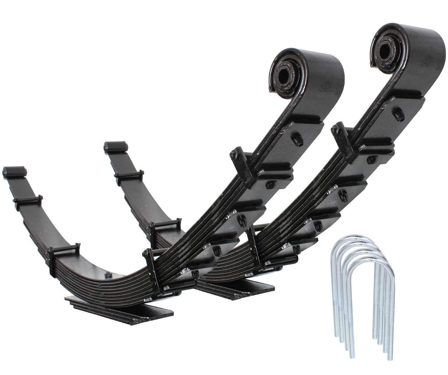

If your going to add air bags, you could also add a set of carli deaver springs to the rear at the same time. Then it would ride like a cadillac empty and tow level when loaded. Best of both worlds.
i dont tow much so i didnt add the air bags,,but the rear springs are lifechanging
Can you install just deaver springs without doing a front lift? I don't tow anything heavy too often so I'd like to add the Deavers now and then assess the need to add Sumo/Timbren bump stops or airbags at a later date.

The deaver springs I installed didnt change the rear height at all that I could tell. I drove the truck with a pintop level up front waiting for the rear springs and truck seemed the same before and after as far as rear height. Rides a lot better now, but definitely squats with a little weight.
What would I search for just the rear kit for a 2022 Diesel? Everything I'm seeing is either by individual components or as a full front/rear package.
Same for me - I did 3.5" Carli E-Venture and added Deavers - my rear end height is same as it was stock.
