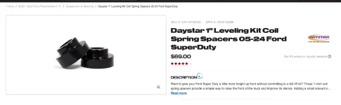

2024 Diesel Tremor - Not seeing many options for just 1" of leveling. Came across this one, assuming this sits on top of the coil spring in lieu of the isolator? Good / Bad? Wondering if this would make the install easier...
With 1 - 1.5" of lift does the Tremor suspension still need updates to the track bar / castor etc? Tremor shocks long enough? Information on the web is pretty scattered.

The 23+ is less sensitive to axle shift due to the improved geometry. I think you’ll be fine but you can always add a track bar drop bracket or adjustable track bar later. I also think caster sensitivity has improved but have not had an alignment to be sure.
Also I prefer the PMF lower spacers since the upper ones are visible.
