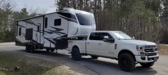

Thought I should add this in for extra perspective on the height. I’ve got the taller Andersen and with the ball in the mid position I’m running a little nose high with probably 9” or so of bed rail clearance. I’m going to try the lower setting next time around to see if that helps level things out.
Thought I should add this in for extra perspective on the height. I’ve got the taller Andersen and with the ball in the mid position I’m running a little nose high with probably 9” or so of bed rail clearance. I’m going to try the lower setting next time around to see if that helps level things out. View attachment 18336
Do you have the coupler forward? How’s your turning as far as cab clearance and bed side when it’s turned? Does the pin come anywhere near hitting the rails
The coupler is forward as of now. Just picked up the trailer on Saturday so haven’t had much time to play with it yet and measure turning radius, but from just driving it around and turning in and out of our weekend spot and bringing it back to the dealer for service I haven’t had any issues. It’s at the dealer now getting the refrigerator fixed, but they say I should be getting it back tomorrow so I’ll see if I can do some measurements then.

with Your bed rail clearance, you can easily drop it two setting and still be at 7 inches. hope your fridge works soon, enjoyed a warmish trip at the lake last weekend. On another note, I am sure you can turn the Andersen around and keep your turns to 80 degrees, but no need to with the hicap pkg. I feel confident on my tight turns knowing there is no way I am hitting my cab, and truck handles the weight nicely.

I have the taller one and like the extra adjustability. If I’m somewhere I know I’ll be going slow and taking sharp turn on uneven terrain ill put it in the highest setting to get the most bed rail clearance. I don’t think you’d have problems with either though.
Is your camper fairly level when hitched?
I think it’s level enough, it’s still a little nose high in my opinion. I normally tow in the low setting, but with the bedrail clearance I don’t think I could go much lower even if I had more adjustment. Maybe someone with the lower one will chime in on if they can run in anything but the higher setting. I think that’s more of a product of the truck being as tall as it is than anything. My fifth wheel is also already at 13.5 ft tall so I can’t really adjust it higher at the axles to compensate. That’s going to vary a bit from trailer to trailer though.
I have the lower one and my ball is on the lowest setting. Have 6.5 inches of clearance to bed rails. My trailer is a 2019 Jayco eagle. It still is nose high. Obviously the trailer hitch itself could be adjusted but I'm at a safe bed rail clearance and its not egregiously nose high.

I have the lower one and my ball is on the lowest setting. Have 6.5 inches of clearance to bed rails. My trailer is a 2019 Jayco eagle. It still is nose high. Obviously the trailer hitch itself could be adjusted but I'm at a safe bed rail clearance and its not egregiously nose high. View attachment 38710
