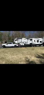

I tow my grand design momentum with an Anderson ultimate (standard height) and its great. I have my coupler block turned backwards and have zero clearance issues. When the block was forward, my hitch could potentially contact the rail for my tonneau cover if making a tight off camber turn.

In the picture, it appears your Grand Design is riding nose high. Can you tell me the measurement between the bottom of the front of your camper and the ground, when it is hooked up to your Tremor? About how much bed rail clearance do you have? It looks like at least 6 inches. Do you know your tongue weight on the Tremor and have you measured how many inches it squats when towing your trailer?
It’s definitely not nose high. That’s just an illusion because of my driveway. I did know all the measurements initially, but I don’t recall off the top of my head. I want to say it squats about 2.5-inches and I believe I have about 8 inches of bed rail clearance with the ball in the center hole And my pin weight all loaded up is right around 3100lbs. I’ve towed it about 1200 miles this year and no issues at all

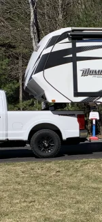

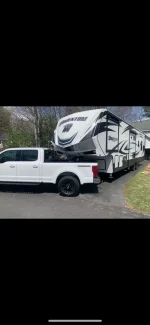

Here are my clearance measurements hooked up.
one from the ground to the bottom of the front cap and one from the cap to the top of the bed rail. The ball is on the middle hole and it’s the standard height Anderson’
The bed clearance is 9. It’s deceiving the way the photo shows. I forgot to measure the squat
