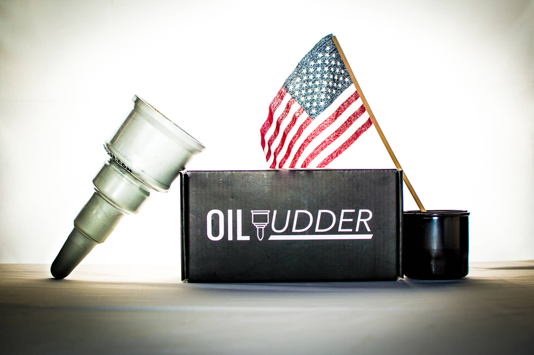

I'm on the edge of ordering the oil udder.
After watching a tech make an absolute mess out of my skid plate on the last oil change (I know, but I was a few thousand miles away and couldn’t do it myself), I determined I need some thing relatively foolproof. What is this oil udder you speak of?

Done both. Hole and udder and still made a mess. When just using the udder XL the amount of oil overwhelmed the space. Next will be a combo of both or let it all drop into a five gallon bucket. Fumoto drain valve with plastic hose works like a champ.
Don’t know what to do now.
Think I’ll give it a go, haven’t come up with a better idea given the really limited space. Guess I can’t do any worse than the Ford tech, right? 🤣

Limited success. The Stahlbus drain worked incredibly well, no drips at all. The oil udder had very limited success. There simply isn’t much room between the bottom of the oil filter and the top of the skid plate to work with. I was going to drain the oil udder by attaching a 3/4 inch plastic tube to the bottom of it, but that quickly went the way of the buffalo (sorry, bison for you purists) when it became apparent there was no room to work with in there. So, I put the capped udder on the filter and loosened it. Got a fair amount of oil in the udder, managed to spill some getting it out. PITA to work around the skid plate openings. I now have slightly more empathy for the Ford tech who spilled oil on my skid plate the first time. In any event, I wound up putting a handful of rags on top of the skid plate under the oil filter, let it drip til done, then took it out (over the front axle was the best non-spill route). With the rags keeping the oil from spreading across the whole skid plate, it was a simple wipe up job after that. Hope this helps someone. 😎
Thanks for the follow-up! Will save my money on the oil udder then, and stick with cut-off milk jugs. Pre-emptive rags are a good idea, and I don't know why I haven't thought of that yet. Will absolutely be doing that next time.
