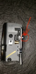

I have looked at videos and have tried to get my Popeye arms behind the seat, but I cannot feel the nub that releases the seat. Anyone have any 2020 picture to validate that the 2017-19 videos I have found are still accurate on the release mechanism?

Get you a wrench, 1/2” or whatever size is long enough to reach the little bolt thing that pokes out on the left side of the latch. Pull up and the seat will fold down.
also can go to built rite industries and watch their install video and see how he does it.
I found the issue. My forearms are too big to get far enough down to feel the latch I need to get a wrench on to release the seat back. I got a slightly smaller neighbor and they felt the nub immediately, and could get a wrench on it, and it opened immediately.
It is important to note, the release is in-between the brackets, not outside of the brackets towards the middle of the truck like you might assume from the picture.
It's the same as previous years as the photo below shows. I will share a bit of disappointment - with the BO sound system and subwoofer, there isn't much room back there for more stuff. I figure my winch controllers will live back there, and maybe a few other infrequently used odds and ends.

Thanks for the picture @Rock Taxi. Is this the nub that needs to be pulled? Pulled UP?
And is that nub on the drivers side of the bracket (I can't tell which side is up in the picture)? Other than finding skinny arms, you're making this easy for the rest of us. Time to order a red Built Rite thing.

Yes, that is the piece that needs to be pulled up - the opposite direction of the red arrow - or towards the headrest.
It is in the middle of the brackets it clips into, towards the middle of the truck (or passenger side).

As far as without it, I saw it mentioned above ... just use a box end wrench to grab the catch. If you raise the bottom of the seat slightly it will actually pull the back away from the cab and grant a little more room.
Here is what it looks like.

Thanks for the photos and description. I was able to get it with a little effort once I knew what I was feeling for blindly.
